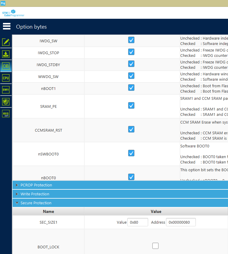

i'm using STM32Cube Programmer , also I followed the instructions in AN2606 , the application note states that it should follow pattern 15 , as far as I can view the option bytes using the onboard ST-Link:
BOOT_LOCK(bit) = unchecked
Boot0(pin) = manually set high
nBoot1(bit) = checked
Boot0_SW(bit) = checked

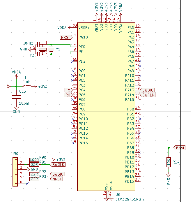

2025-06-23 8:03 AM
This is the schematich
Chip receives on PC5 and transmits on PC4 (USART1).
Boot0(pin) manually set high before reset.
2025-06-23 8:21 AM
> I'm using STM32G431RB, and I am trying to flash the MCU via UART1 using PA9 and PA10 pins but I can't make it work ..
PA9/PA10 don't appear to be connected to anything in the schematic.
Schematic shows an X on some pins but not others which seems suspicious.
So are you using PC4/PC5 or PA9/PA10? The bootloader does not support PC4/PC5.
2025-06-23 8:44 AM
I tried with PC4 and PC5 (USART1).
Considering I'm using STM32G431RB, which pins should I use?
