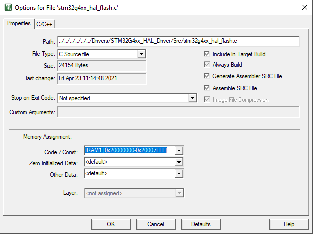

2021-08-30 7:59 AM
Easiest is to open source file options using right mouse button and set SRAM as memory assignment for code. For finer adjustments you need to build your own scatter file.

@JHOUD I also noticed that the GCC option for Keil doesn't let me easily put that file in SRAM. Did I miss something?
