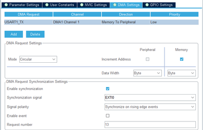

uint8_t tx_dma_buff[13] = {"hello world\r\n"};
HAL_UART_Transmit_DMA(&huart1 ,tx_dma_buff , 13 );

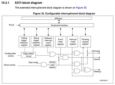

EXTI->SWIER1 |= 1<<0; //software trigger
I want this software interrupt to be able to synchronize dma。
