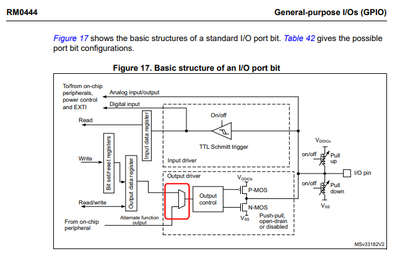

@danielbathtub - you can see this in Figure 17 in the Reference Manual:
The multiplexer connects either the Output Data Register (ODR) or the Alternate Function (AF) to the output driver.

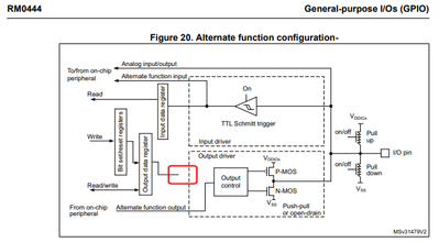

Figure 20 shows the case when the output is configured as AF:
Note that the ODR is disconnected from the output driver - only the AF is connected.
So your software writing to the ODR in this case will have no effect.
