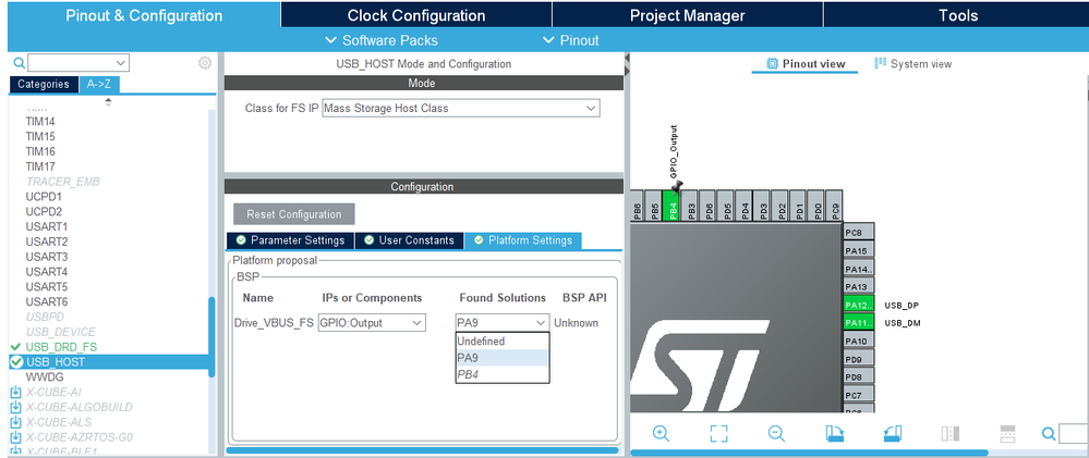

hi,
Using STM32G0B0CET6
USB_DRD_FS---Host_Only_FS,
USB_HOST---Mass Storage Host Class,
FATFS---USB Disk
USB Interrupt---Enable.
 Screenshot 2024-09-26 145107.pngMy requirement: i just want to create  and write the file to usb_host.c and whenever i pluged the usb, the file automatically copied from microcontroller to pendrive. i did, its working fine but i have a doubt,
 Everything seems clear, but why should i configure to  Drive_VBUS_FS option.
On my board, I decided to provide 5V to VBUS directly . This makes me wonder if VBUS sensing is possible at all?
And for the Drive_VBUS_FS, I don't want to drive VBUS, but there is no such option available except for keeping the selection at Undefined, which seems to be an invalid state.
we don't have a additional pin of Drive_VBUS_FS, what should i do?

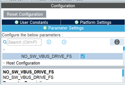

FBL
Hi @Berlin-raj123
You referenced two different part numbers STM32G0B1RCT6 and STM32G0B0CET6.
VBUS sensing are mandatory for self-powered devices only. In your case, you can simply select in the configuration NO_VBUS_DRIVE is needed
Best regards,
FBL
