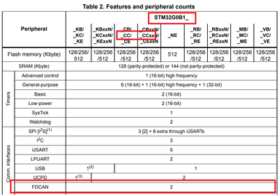

Hello @Vika43121,
This information is something that you can find in the datasheet of the product, especially the table "Features and peripheral counts":
So stm32g0b1cct6 has two FDCAN instances.

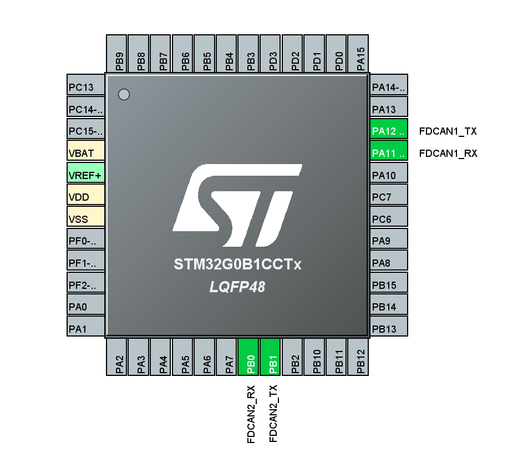

2025-05-15 12:04 AM
It seems to have 2 FDCAN peripherals
and this person is using FDCAN2 for the bootloader

Hello @Vika43121,
