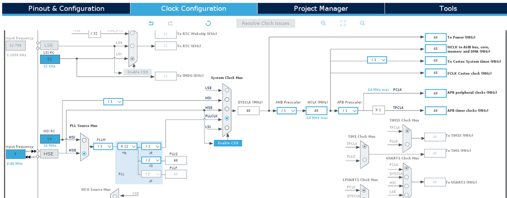

I believe that my problem has to do with the main clock. I have configured my clocks to be the following(USB is set to use PLLQ, not HSI48):
Even though the PLLQ is set to 48MHZ the setup does not finish correctly. Could this be due to the relatively slow clock(8MHZ)? If so, is there a better frequency to use for the external oscillator in order to provide good USB communication?

1. What's not finished correctly on setup?
2. Your USB works fine with one com channel, so why you think it has to do with the clock and not your program is the problem?

For USB, the HSI48 synchronized to USB SOF is a perfectly correct clocking option.
Edit: Look at the log in the original post - the problem is diagnosed. Endpoint sizes are too big, PMA configuration will be incorrect (overflow - too much space used). reduce data in and out endpoint sizes to 64, set the notification ep size to 10 or 16 (notification ep is usually mislabeled as "command"). Verify the consistency of ep size setting in config descriptor and hardware device configuration.
The device fails to enumerate with error -32. From what I've read, this is EPIPE, which means that the device did not respond back in time.
Because if it is plugged into my computer it will not work. If I leave it plugged in but then connect it to my VMWare virtual machine, it enumerates properly. I believe this is because VMWare effectively has a virtual USB hub that is more tolerant of the timings.

If I use the HSI48 I can't enumerate the device in this configuration.
