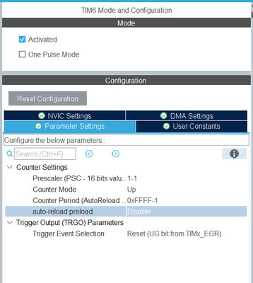

My settings for Timer 6 are as follows:

Timer configuration was done as below:

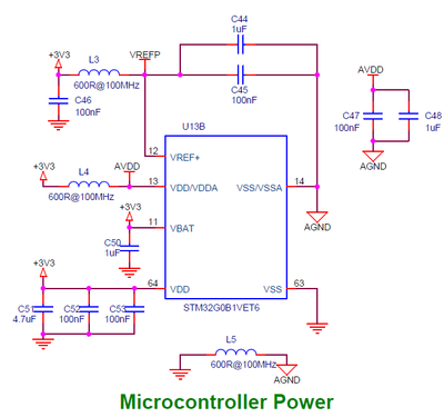

Since this is a custom board, consider showing your schematic. Ensure decoupling caps are present and rails are steady.

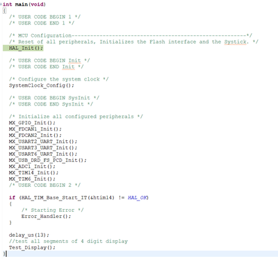

I tried debugging to check what exactly is happening when program hang up. During my step by step debugging in main() function, i have following observation:
If i set breakpoint then I get cross line over breakpoint and execution does not stop at breakpoint. My compiler optimization level is set as -0.
When I debug from HAL_Init() function in main(), it goes through all functions successfully (F6 - step over) but when it comes to function delay_us() and if F6 - step over is done then debug cursor (green highlight over function name) gets lost. No error message and screen just remains at that point till I suspend debugging.
If I do F5 - step Into on delay_us() function then it does goes inside the function and goes through all lines of code successfully and does come out of this function too. But then when it goes to next function - Test_Display() after delay_us(), then again If I do step over or step into, debugging cursor gets lost i.e. green highlight over function name is lost and screen just remains at that point without any error message till I suspend debugging.

Schematic for power section of microcontroller is as below:

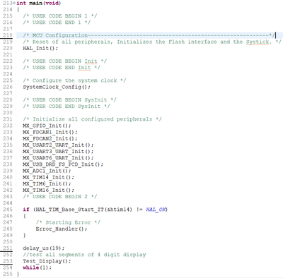

2025-03-06 12:11 AM - edited 2025-03-06 12:13 AM
After putting while(1); in the code, observations remains same i.e. debug cursor gets lost in delay_us() function. Hitting "pause" icon lead to stop somewhere in interrupt service handlers. Every time in different handlers and at different statements of code which is auto generated by tool.
I also tried following but behavior remains same
1. using timer16 instead of timer 6.
2. merging code of delay_us() function directly in main() function
3. Increasing minimum stack size from 0x400 to 0x800
4. Replacing Test_Display() function by another code which writes to GPIO pin
But if I use HAL_Delay(1) function then it works. But 1ms delay is too much for my application.
