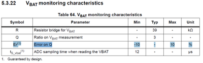

According microcontroller datasheet "5.3.22 Vbat monitoring characteristics", the minimum ADC sampling time when reading the VBAT should be ts_vbat = 12us. This is a limitation for my application and I would like to reduce this time.

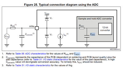

Cain sounds like you have connected an external capacitor as it is on that figure under Cparasitic.
In that case, at the moment when sampling begins (and Cadc is at unkown, i.e. presumably worst case voltage, let's assume 0V and let's assume voltage at Cain - let's call it Vain - is the maximum i.e. VREF+), these two capacitors form a capacitive divider, i.e. the voltage at Cain drops to Vain *Cain/(Cain+Cadc), i.e. with your values it drops by some 0.5%. Let's assume Vain=VREF+, LSB of 12-bit ADC is cca 0.0244% so then the drop is cca 20LSB.
Now this drop is going to be charged from the external voltage source through Rain to both capacitors in parallel, from which Cain prevails, i.e. this charging has time constant tau = 10kOhm*1nF=10us; if I am not mistaken it takes two tau to get from 20LSB to 3 LSB, so that's your minimum sampling time.
Using relatively big capacitor at the input works only if it is big enough so that the drop is negligible, but also the period *between* samplings is long enough so that the capacitor gets recharged from the external high-impedance source. If this won't suit your purposes, you'd have to resort to buffering.
See also AN2834, especially ch.4.4.

> 1. What is the technical reason for this minimum ts_vbat = 12us, while others like "ts_temp" or "ts_vrefint" have much lower values?
VBAT is measured at a resistor divider (possibly followed by some amplifier), and this source has a higher impedance than the outputs of temperature sensor and vrefint source.

> 3. Which could be the impact in the "Error on Q" if we configure in our application the ts_vbat = 10us?
I don't know what's "Error on Q".
Failing to observe adequate sampling time according to signal source impedance results in the ADC readout to be somehow influenced by the previous conversion (i.e. previous channel's voltage), but the relationship is not straighforward nor documented.

"Error on Q" is the error in [%] on "Ratio on Vbat measurement" described in the microcontroller electrical characteristics:
