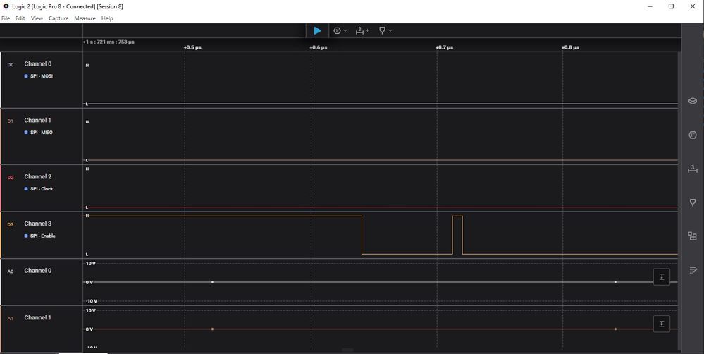

- STM32G071R8T6, DMA chan 1 ADC's, DMA chan 2 SPI TX, DMA chan 3 SPI RX and DMA chan 4 DAC
- Tested the SPI configuration without the DMA to a SPI EEPROM and it works.
Once the DMA configuration was used, we do not see any data being transmitted.
The initial DMA based communication to the EEPROM is a read command, address and then 0x55 data so that we clock the EEPROMs response back. The Chip Select to the EEPROM is done manually. Because the initial testing done wrote directly to the SPI registers, it seems like something in the configuration of DMA to SPI is not correct. We have used the STM32Cube Repository version STM32Cube_FW_G0_V1.6.1 for Low Level examples but the DMA and SPI are not tired together for the G071(they have HAL based.)
- If we remove the call to LL_DMAMUX_SetRequestID(), which is needed because the G071 has a DMA mux, we will receive a DMA1_Channel2_3_IRQHandler interrupt after the TX DMA is triggered. There is still no data being transmitted but the interrupt fires.
Any help is appreciated.

2024-04-29 12:55 PM
Appears we had the transmit addresses backwards.
LL_DMA_ConfigAddresses(DMA1, LL_DMA_CHANNEL_2, (uint32_t)txSpiBuff,
LL_SPI_DMA_GetRegAddr(SPI1), LL_DMA_DIRECTION_MEMORY_TO_PERIPH);
