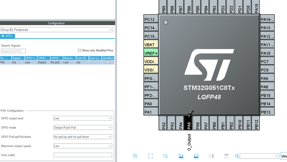

I turned off all the other configuration aka Alternate Functions..only enabled GPIO PA5 as output Pushpull mode, low freq.its doesnt turn on or off individually..tried to turn on and off using HAL as well as direct registers..both work only when PA4 turns on ...what i mean if i want to turn on PA5 i should turn on PA4, then only it works..what is this causing this issue.can you help me out.tried on multiple hardwares..same issue so hardware issue eliminated, no pin short circuit.

@Ozone @KnarfB Thanks for the ANswers..@OZone Schematics and board is a simple dev board which extends the pins of ic to more usable berg strip and programming done via direct 3v3 to SWD interface which works for past 8years.No hardware issue found. @KnarfB i looked into debugginf SFR register of GPIOA..
both PA4 and PA5 Configured as ouput. both turned on and off after 2 sec => step by step debug reveals while starting..
after HAL_init->MODER register 0xebffffff,IDR=>0x00,ODR=>0x00
after GPIOA clock enable-> IDR=>0x400,
after GPIO init-> IDR=>0x400, MODER=>0xebfff5ff
and come into while after PA4 writen on ->IDR=>0x4010,ODR=>0x10(till now ODR is 0x00)
and after PA5 is written on->nothing changes
while doing this repeated debug steps..both PA4and PA5 configured as GPIO(removed PA4 in another test still same result)..and turing PA5 only ON and OFF...step by step reveals...
after HAL_Init->MODER register 0xebffffff,IDR=>0x00,ODR=>0x00
and come into while after PA5 writen on ->IDR=>0x4020,ODR=>0x20(till now ODR is 0x00)
and come into while after PA5 writen off ->IDR=>0x4000,ODR=>0x00..
Please help me out on this issue..i attach my code also
