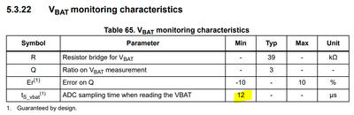

Per the datasheet, VBAT has a minimum 12us sampling time. 12.5 cycles is almost assuredly not enough if you're using typical ADC clock speeds. Bump up the sampling time to max.

What it does when not calibrated, and what it does with <12 us sampling time is immaterial. Focus on what it does with proper calibration and with proper sampling duration.
Note the measurement is only as good as your VREF+. Sounds like this may be slow to come up. Check proper VDDA and VREF+ layout and voltage stability at the time of the measurements.
