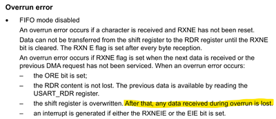

On G030 if an overrun occurs on usart2 (no FIFO available) the reception of further bytes stops.
Is this intentional or an known error?

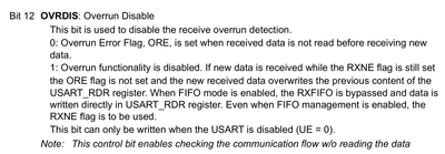

2024-07-25 12:44 PM - edited 2024-07-25 12:45 PM
This is intentional, as outlined in the RM.
You can set the OVRDIS bit to overwrite the data with each new received byte rather than flag it as an error, but this of course also loses data.
