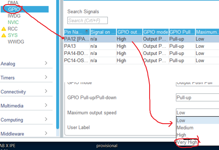

Also you could set the GPIO SPEED to very high
I dont know how much time this will save you....
