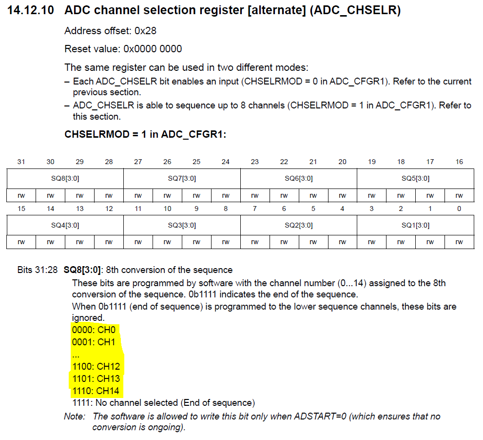

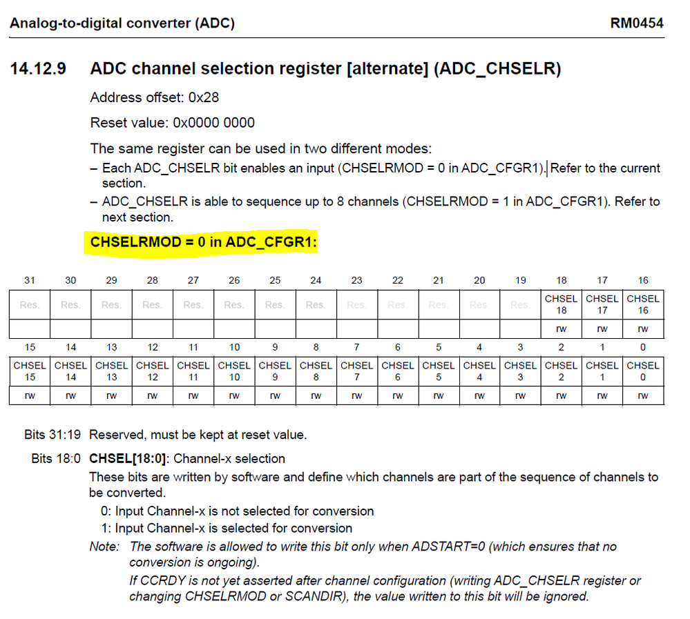

2020-08-11 5:37 AM
Check your CHSELRMOD bit. If it's 1, only channels 0-14 may be selected for regular conversion.
If it's 0, you can select any channel.
2020-08-11 5:46 AM
Set it up in CubeMX to see the correct code to convert channel 15+.

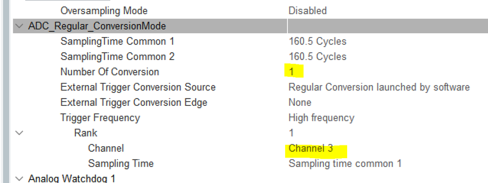

@TDK
I have used CubeMX, though it didn't give me any error. Original project files are attached with question
Your project only converts a single channel, channel 3. The error is not in the CubeMX generated code, it's in the user code you added.
Channels 1, 15 and 16 are set up as inputs, but they're not actually part of the conversion in your project.
