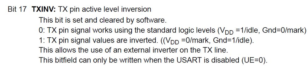

No matter what I do with the control registers (UART_ADVFEATURE_TXINV / UART_ADVFEATURE_DATAINV), the data output & idle state don't seem to change.
EDIT: DATAINV and/or TXINV do seem to invert the data bits but the idle line is *always* LOW when there's no data no matter what.

UART is normally idle high. You've flipped polarity with TXINV, so now the line is idle low. Are you expecting it to only invert data bits and not start/stop/idle as well?
2022-03-03 6:10 AM
Please check what I said - there is NO combination of TXINV and DATAINV that lets the TX idle high despite what the datasheet says.
