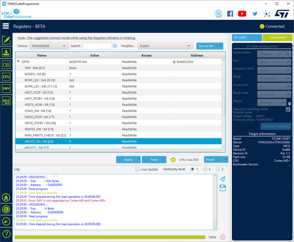

2021-11-22 8:32 PM
Ok, I got a workaround, changing bit nboot_sel from 1 to 0 fix the problem of bad reset while debugging.
2021-11-22 9:18 PM
This is because G0 goes down to small pincount packages, hence Reset can be gpio, boot pin is also swd signal for debug.
