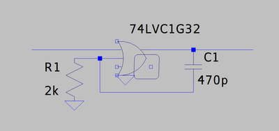

2025-06-20 4:10 AM - edited 2025-06-20 4:10 AM
just put a simple gate at the pin, making any positive pulse longer (1 us or so):
...and problem solved.
