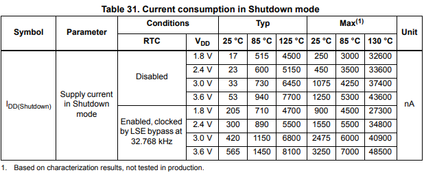

Please check the parameters mentioned in the DS12232 and precisely in table 31.
To minimize the power consumption in low power mode, I advise you to take a look at How to minimize the power consumption in low power mode: An example using NUCLEO-F401RE board article.

Thanks @Sarra.S I had taken all those measures. It would be nice if there was an official example (for Nucleo?) in STM32CubeMX to showcase it so users would know they have not made a mistake.
@KDJEM.1 thank you for pointing that out. The variance is significant. It looks like the advertised 40nA is maybe not as "typical" as it is a lucky measurement, it loses its meaning as it can't really be relied on for ultra low power. So at room temperature (25C) it can vary from below 100nA to above 1000nA. It looks like I was doing everything right then and it's just what it is.
Case closed.
