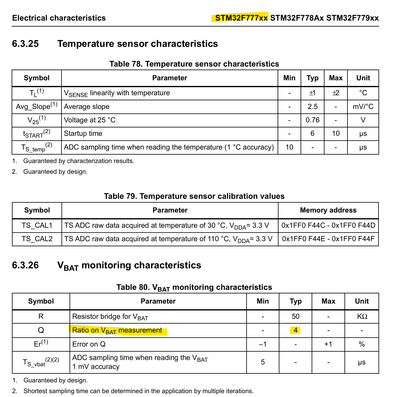

The data sheet for the STM32F7 states that VBAT on the ADC is divided by an internal 1/3 voltage divider. But it turns out that the ratio 1/4 must be used to calculate the correct voltage. In addition, if the VBAT pin is pulled to ground, approximately 0.8 volts are still measured. However, other voltages such as 2 volts are measured correctly.
Why is the voltage division ratio different than in the data sheet and why are the 0 volts measured as 0.8 volts? Are we doing something fundamentally wrong here?

The F777 data sheets shows a ratio of 1/4 from what I see. Perhaps you have an outdated version? Or another chip?
The VBAT measurement has a minimum sampling duration of 5 us. Are you satisfying that? Use the largest sampling time possible for the most accurate result.
