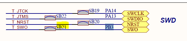

Check if there is any solder-bridge configuration on the board impacting the connectivity of PB3 (SWO) to the ST-LINK portion of the board.

Thanks for replying. I looked at the schematics and PB3 is connected to SB21. I believe that SB21 connection is already soldered isn't it?

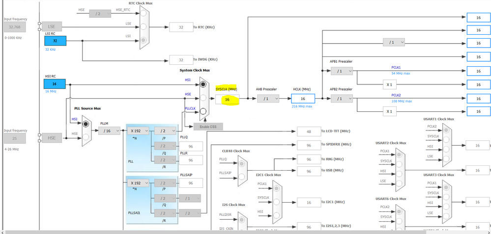

I checked the clock configuration in cubeMX and it is as follows. I tried setting the System clock to 16 MHz and added these lines in __write() function.

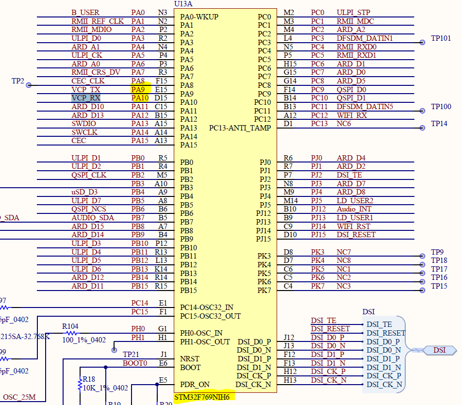

In the schematics, the VCP_RX and VCP_TX are connected to PA10 and PA9 respectively. So I configured PA9 and PA10 as USART1_TX and USART1_RX respectively. Then I configured USART1 and was able to print using HAL_UART_Transmit(). I was able to see the output via virtual COM port.

I checked these already. In UM2033, page 20, 6.15 it is said that 'The serial interface USART3 is directly available as a virtual COM port of the PC,'. But according to the schematics, the virtual COM port is connected to USART1(I verified it too).

You have to solder R92 (between the the SD card connector and the MCU)
This was the fix ^^^
