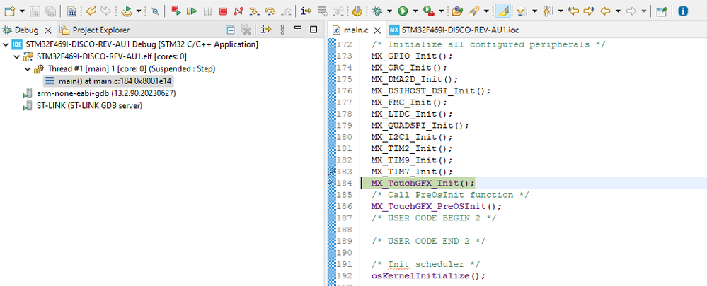

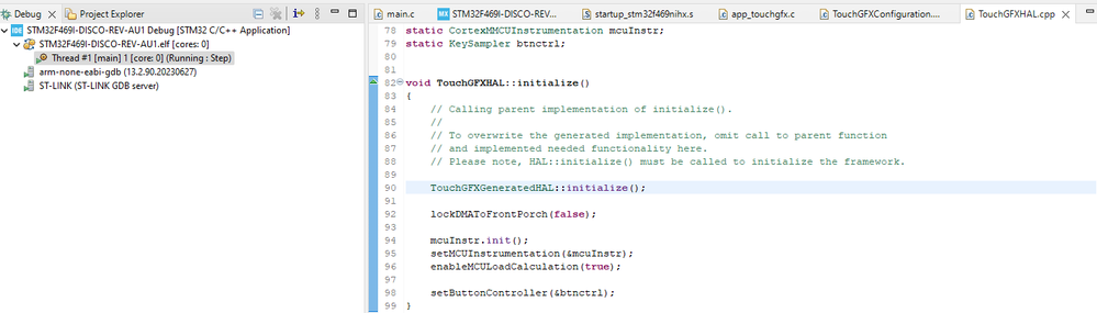

Right now, the MX_TouchGFX_Init(); does not finish. See screenshot.
EDIT:
We seem to stop here:

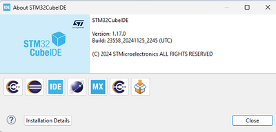

CubeIDE Version: 1.17.0
TouchGFX Version: 4.24.1

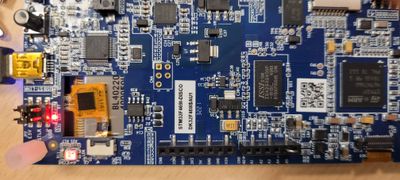

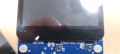

I always used this board in TouchGFX:
Disco Board Version:
Thanks,
