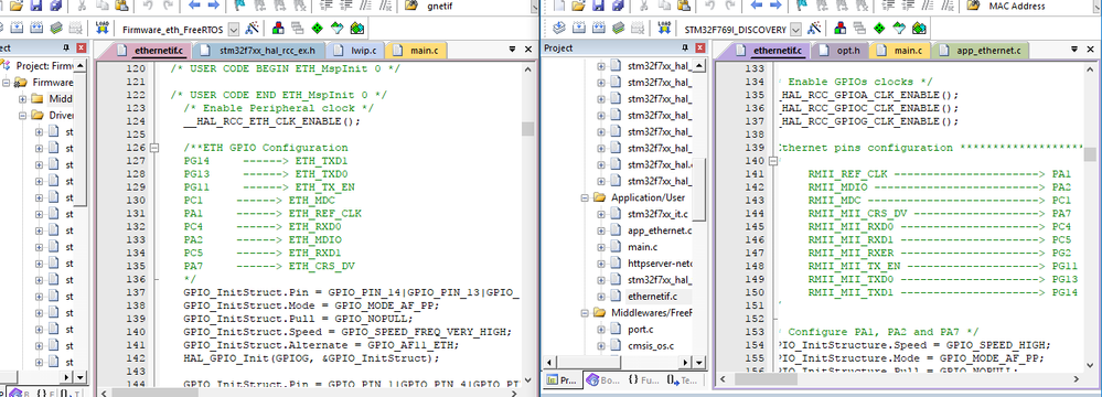

2017-09-28 1:53 AM
Dear Avatar,
I think cube generated code has some problems. When I compare ethernet initialization, some pins are missing such RMII_MII_RXER pins.
I believe my STM32Cube file is not correct.

2017-09-28 4:22 AM
When MX_LWIP_Init() funiction is called, netif_is_link_up(&gnetif) is always false.
That's means ethernet link doesn't up.
That's why I suspect it in hardware initialization.
That sounds correct.
Unfortunately I don't have a F769I Disco board, nor I am using Cube, so I can't help you with that.
But Cube is known not to be 100% bug-free, to state it cautiously.
If you have a working example, I would try to copy the init code from there.
2017-09-28 4:22 AM
Hello
thihakyaw.job
,Could you please precise the version of CubeMx and firmware you are using ?
Have a look to the datasheet and check the pin assignment as the PG2 is used by FMC.
Also, refer to the errata sheet related to your device to check if you have the same conditions as described in the errata sheet.
Please, keep us informed about your progress.
Kind Regards
Imen
