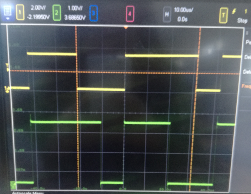

I have an issue with using two channels of DMA to generate the PWM on PA2 and PA3 pins.
I configured using CubeMX TIM2 PWM Generation CH3 and CH4.
I have added the DMA memory to peripheral for PA2 DMA1Stream1 and for PA3 DMA1Stream6.
The issue I have is that only the DMA1_Stream1_IRQHandler is called and only the PA2 PWM generation is done. DMA1_Stream6_IRQHandler is never called.
This is what I use to test PA3 pin.

2020-02-06 10:20 PM
I have managed to set-up the desired PA3 to use DMA but only with Steam7.

The CubeMX is blocking selecting both CH3 TIM2_CH3 (Stream1) and CH4 TIM2_CH3(Stream7)...

Ok, thank you. It works now. I have used different variables in the code (initiated in tim.c with a name and used it in DMA_Config, another variable) and it was not the same addresses :D
Now it is working.
