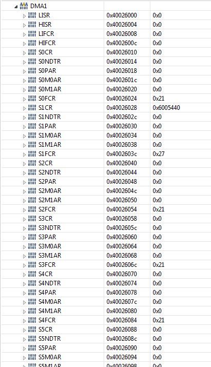

2020-02-06 12:18 AM
I have changed like suggested and the IRQ is still not called.
2020-02-06 12:42 AM

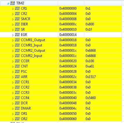

Read out and check/post the TIM and DMA registers content.
2020-02-06 2:48 AM
TIM2
2020-02-06 2:52 AM
2020-02-06 3:09 AM
As I see all SxFCR.FEIE are set to 0, no IRQ enabled...

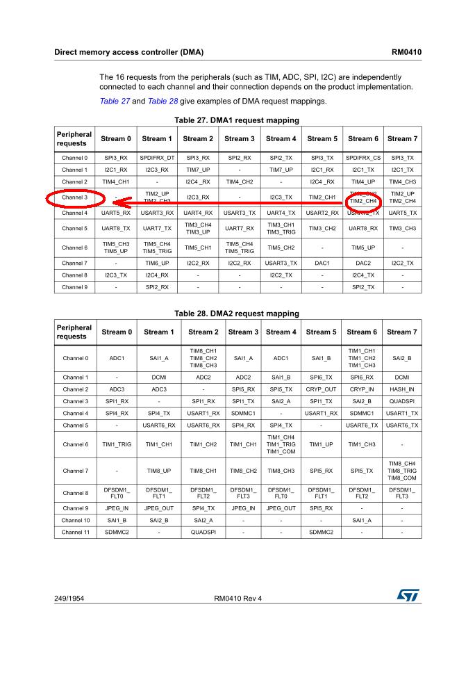

2020-02-06 9:23 AM
Your problem is with DMA1 Stream 6, and you post registers only for stream 0 to 5...
So you don't want to get help with this or what?
2020-02-06 9:23 AM
/* Several peripheral DMA handle pointers point to the same DMA handle.
Be aware that there is only one stream to perform all the requested DMAs. */
Okay, so this may be a Cube/HAL limitation.
Ditch Cube, go for the registers.
