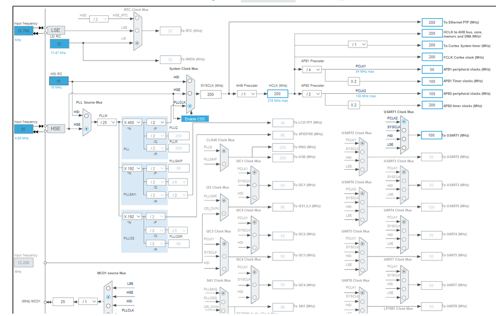

I've verified that SYSCLK is 200MHz via MCO1 (SRC PLLCLK) whether the debugger plugged in or not -- so the clocks are correct. Using Keysight scope w/ Tektronix 1103 TEKPROBE.
