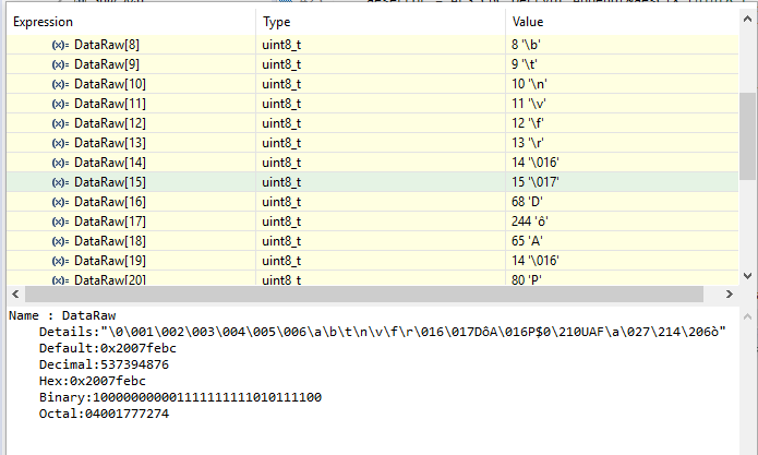

.This is what i get when i run it.
Which is wrong since the plaintext goes from 0-31.
Anyone know what im doing wrong?

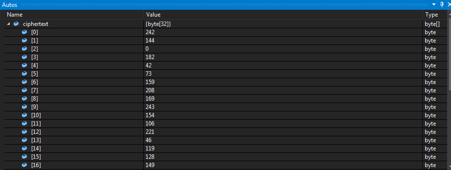

ICryptoTransform encryptor = myAes.CreateEncryptor(); encryptor.TransformBlock(plaintext, 0, 32, ciphertext, 0);And hereare the values of the ciphertext at the end of executing the above:
