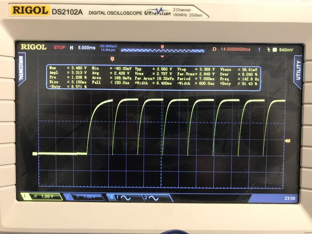

I can connect with JTAG via SWD and load a simple program but after load the system won't run to main. The chip seems to be stuck in some hardware system reset loop. Attached is an image of the nRST pin. I've gone through AN4661 many times and can't figure it out. Power rail looks good and I have BOOT0 strapped low, PDR_ON strapped high. Any ideas?

Here is an image of the reset pin right from power applied. Instantly goes into this state.

Also, check the option bytes using whatever programmer you are using, specifically the "user configuration" bytes. Is it possible that when programming the custom bootloader that somehow the option bytes got changed to enable one or more watchdog timers? Or change the boot selection options? I don't THINK this is your problem because the reset period looks the same as your first scope screen shot. But these are (or should be) easy things to check.
