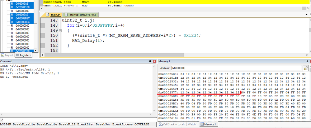

MCU will write to the external sram untill 0x60002577 (usually after reset write until here or a little less)... as you can see i putted a HAL_Delay(1) ms after writing to address if i remove it MCU will write to sram just a little something about 0x60000040 and in both case it generate hard fault error after some writing to sram ( i also am able to read this content).
so does any one has an idea ? what is wrong ? why it can't write in whole of my sram ? why when i delete delay it write less ?

thank you but did not help that much, hardfault is because of AXI bus error and i don't know why exactly is happening ! the problem is i can write to any address of my external sram but just a couple of byte if i want to write a lot of byte this problem will happen ( in case one MPU disable).

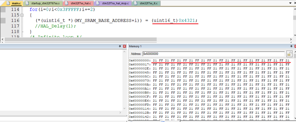

look at the result and compare it with the first result in original post ... now i can write to whole sram address continusly but it seems upper byte won't work!(won't write 34 just will write 12 on sram ) but in first example it will write 1234 if you see . so i don't think it has pin problem . do you have any idea ?

the connection are right is just 19 address and 16 data pin and some cmd pin im sure about it . there would be something else when i put these value :
Timing.AddressSetupTime = 0;
Timing.AddressHoldTime = 0; Timing.DataSetupTime = 2;and turn of the mpu i can write to sram for something about 3000 byte with valid data but when i change this parameter everything will corrupt and also with these value i also am able to write just 3000 byte by valid data then it will corrupt again .
