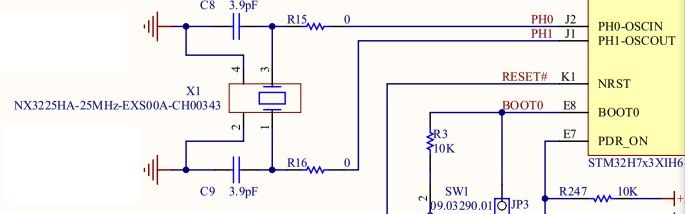

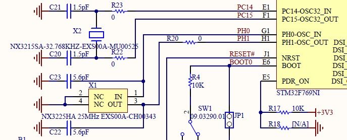

If not the capacitors, need to really review the circuit as built
USB really needs a crystal to meet specs. 25 MHz typically used for Ethernet centric applications so the PHY can be driven of a direct clock buffer rather than off a PLL
They have moved schematics to .ZIP files, Google the boards, go to the Documentation tab for the product, and pull the BOM and Schematics from there.
F769/F779I-EVAL
H743I-EVAL
