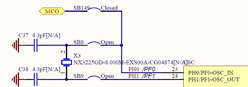

I don't know the reasons why the 16MHz was chosen, but the crystal should be usable. With 4 pins you need to insure you've connected the right two, and not mirrored/transposed them. If the circuit is otherwise electrically sound my concern is that you have close to 3x the required capacitance.
If it is stuck in the loop that indicates that it is not starting/oscillating. I might also check if the SysTick is running, and have fall-thru behaviour to use the HSI if the HSE fails to start promptly.
For a cut-n-paste design, perhaps use the Nucleo-144 as a reference. NDK Oscillator NX3225GD-8.000M-EXS00A-CG04874
https://www.digikey.com/en/products/detail/ndk-america-inc/NX3225GD-8MHZ-EXS00A-CG04874/9172047

I guess systick is also not running but if i choose the hsi as base oscillator than my code is working fine it is just a blink code. but the main problem is i cannot use usb without hse that is the main concern.
Thank you sir . I will try to use capacitor and report you back. and i will try to get those crystal as well. This is really very helpfull since i have been searching a lot for external crystal for nucleo board as well. thank you so much sir for the digikey refrence
