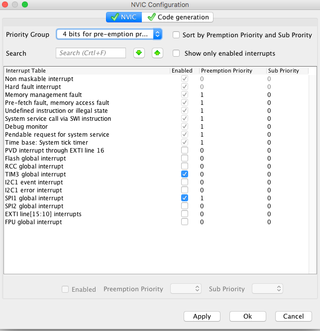

I have a Nucleo F746ZG board and am experimenting with the peripherals. I'm trying to get a regular timer interrupt at a given frequency, and am seeing a huge amount of jitter.
Here's my configuration:
In the interrupt I do this:
void HAL_TIM_OC_DelayElapsedCallback(TIM_HandleTypeDef *htim)
HAL_GPIO_TogglePin(GPIOB, GPIO_PIN_11);
I am then analysing pin B11 on a scope. I would expect to see a frequency of 172.26528.
What I'm measuring is anywhere between 174.6 - 174.9 Hz. It's all over the place.
The SPI interrupt is a lower priority, so shouldn't affect it, but I've tried disabling it anyway, and that didn't help. No other timers or timer channels are enabled, so it should only be TIM3 channel 1 triggering this interrupt.
There's nothing else happening on the chip. I presume it's possible to get better accuracy than this!
Any help would be greatly appreciated.
Matt

Good thinking - I just tried setting every other interrupt I can to a lower priority, and I get the same result.
