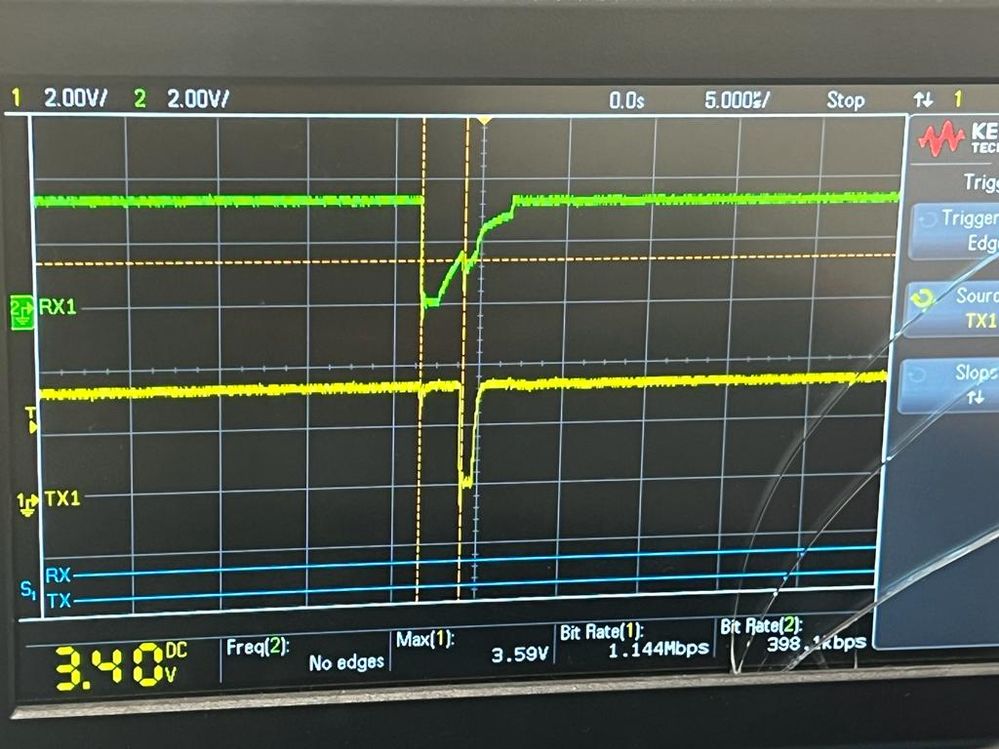

The UART expects 8E1 (Even Parity) for the 0x7F test pattern. Scope the signal make sure it's not glitching, and that you give enough time between doing a reset and sending a pattern. Make sure your UART output pin is high before reset.

The UART output pins are high before reset, I also added 10k pull up to ensure that. both Rx and Tx are glitching at the time I call bootloaderVector->resetHandler(). Rx signal receive 0x7F but no respond transmitted on Tx.
