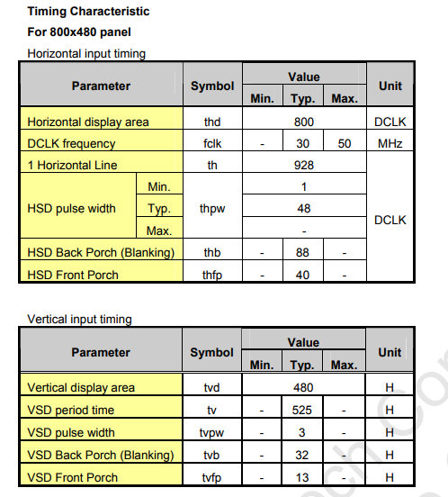

,About ''increase the front porch and back porch as much as you can, see if that helps.''
http://www.buydisplay.com/download/ic/OTA7001A.pdf
option 1:
//#define LCD_7_HSYNC ((uint16_t)120) /* Horizontal synchronization */
//#defineLCD_7
_HBP ((uint16_t)88) /* Horizontal back porch */ //#defineLCD_7
_HFP ((uint16_t)40) /* Horizontal front porch */ //#defineLCD_7
_VSYNC ((uint16_t)50) /* Vertical synchronization */ //#defineLCD_7
_VBP ((uint16_t)32) /* Vertical back porch */ //#defineLCD_7
_VFP ((uint16_t)13) /* Vertical front porch */option 2:
I'm doing.
I'll tell you about results.
Thank you.
2018-04-04 6:10 AM
Dear
Marsh.Nick
option 2:
//#define LCD_7_HSYNC ((uint16_t)240) /* Horizontal synchronization */
//#defineLCD_7
_HBP ((uint16_t)176) /* Horizontal back porch */ //#defineLCD_7
_HFP ((uint16_t)80) /* Horizontal front porch */ //#defineLCD_7
_VBP ((uint16_t)64) /* Vertical back porch */ //#defineLCD_7
_VFP ((uint16_t)26) /* Vertical front porch */Flicker on LCD seems to reduce.

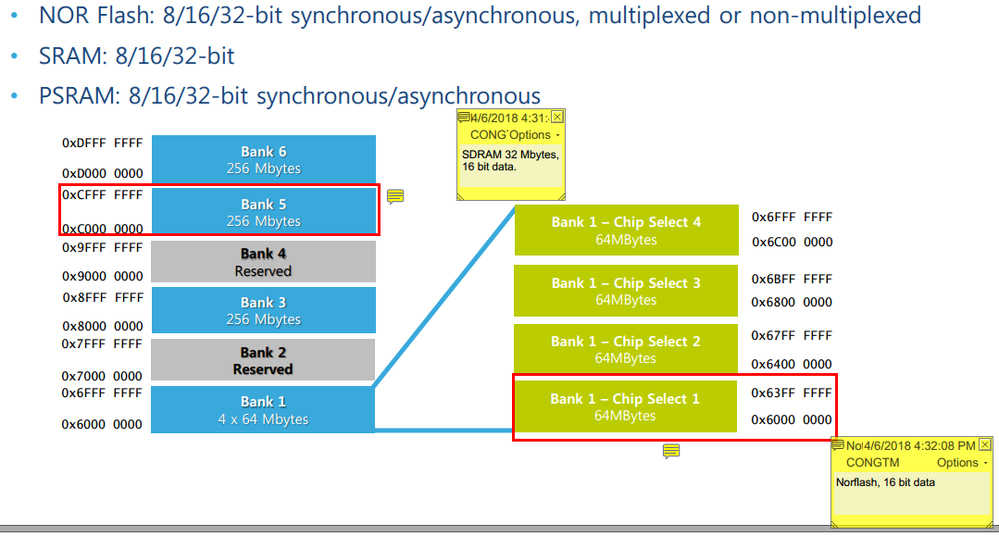

SDRAMusing bank 5 (0xC0000000).
Norflash using bank 1 (0x60000000).
I'll try to change bank 1 to other bank.After that, disable bank 1.

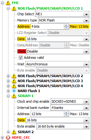

, and every body,Currently, i can't disable bank 1, because hardware circuit.
So, my project using bank 1 (0x60000000 - 0x63FFFFFF).
Bank sdram 1 (bank 5): ) 0xC0000000.
I think i have to change circuit for my project or
upgrade the processor to the new STM32H743, 400MHz.Have you any other advise for me?
Thank you so much!
