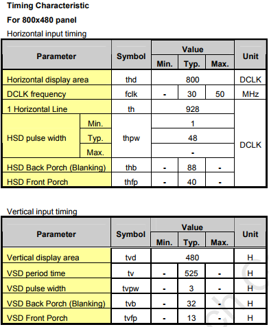

using DMA2D and FMC interface(Flexible Memory Controller – Working at 200/2 MHz).Timing LCD TFT 7 inch from datasheet:
/external-link.jspa?url=http%3A%2F%2Fwww.buydisplay.com%2Fdownload%2Fic%2FOTA7001A.pdf

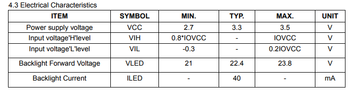

power supply in board: 5V, 3v3....
It is good.
Page 8/19:
I measure VLED is: 19.2V < VLED min = 21V.
However, LCD TFT haven't any
flicker if I don't use bus data SDRAM by other device.
When LCD TFT have flicker (other device use bus data SDRAM), VLED = 19.2V is not drooping.
So, i think ''
power supply'' is not cause.

increase the front porch and back porch as much as you can, see if that helps.

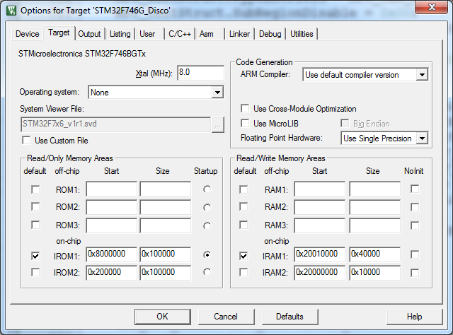

How to enable to use FPU in STM32F746BGT6?
Which toolchain you are using ?
Some IDEs automatically add the appropriate code if you select 'use FPU' during project creation.
How is configure FPU accuracy ...
Single precision (float), not configurable.
... and MCU can run faster?
Proper core clock and Flash settings, and enabling caches.
2018-04-04 3:24 AM
Thanks
meyer.frank
.Toolol chain: MDK-ARM standard version 5.
I enabled FPU:
