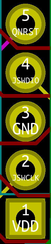

I'm using SWO without trace, and the J-Link connector is this 5-pin connector:
I doublechecked that the J-Link programmer is connected correctly to this connector, and of course I'm able to flash with this. The above pin is connected to NRST, which also has a 10K pull-up (I guess the built-in pull-up would be sufficient).
So why does the connected J-Link (in particular the NRST wire) prevent the startup of the STM32F746? I didn't have these kind of problems with a F722.

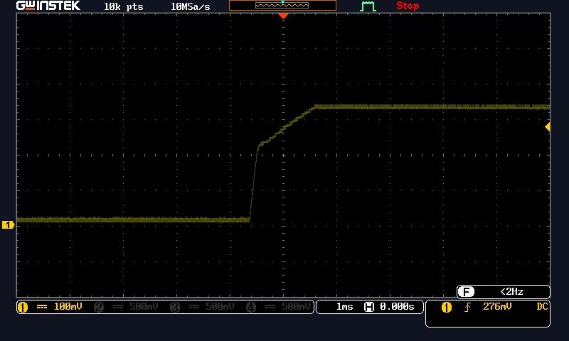

Actually, I was wrong with my analysis, and you all were correct, except that in 25% of cases the STM32 starts normally. In the other 75% of cases, a manual reset does the job.
Looking at the voltage rise, one can see that startup takes more than 1 ms -- in this particular case, the STM32 did not start up (1 grid cell is 1V/1ms, I used a 10x probe).
According to the step-down regulator datasheet: When EN is set to start device operation, the device starts switching after a delay of about 40 μs and VOUT rises
with a slope of about 10mV/μs. That implies that the target voltage should be reached in less than 400 us.
Is there any way to speed up that particular regulator? What could cause the delay? If the curve kept the intital slope, everything should be fine. Should I get a different regulator?
