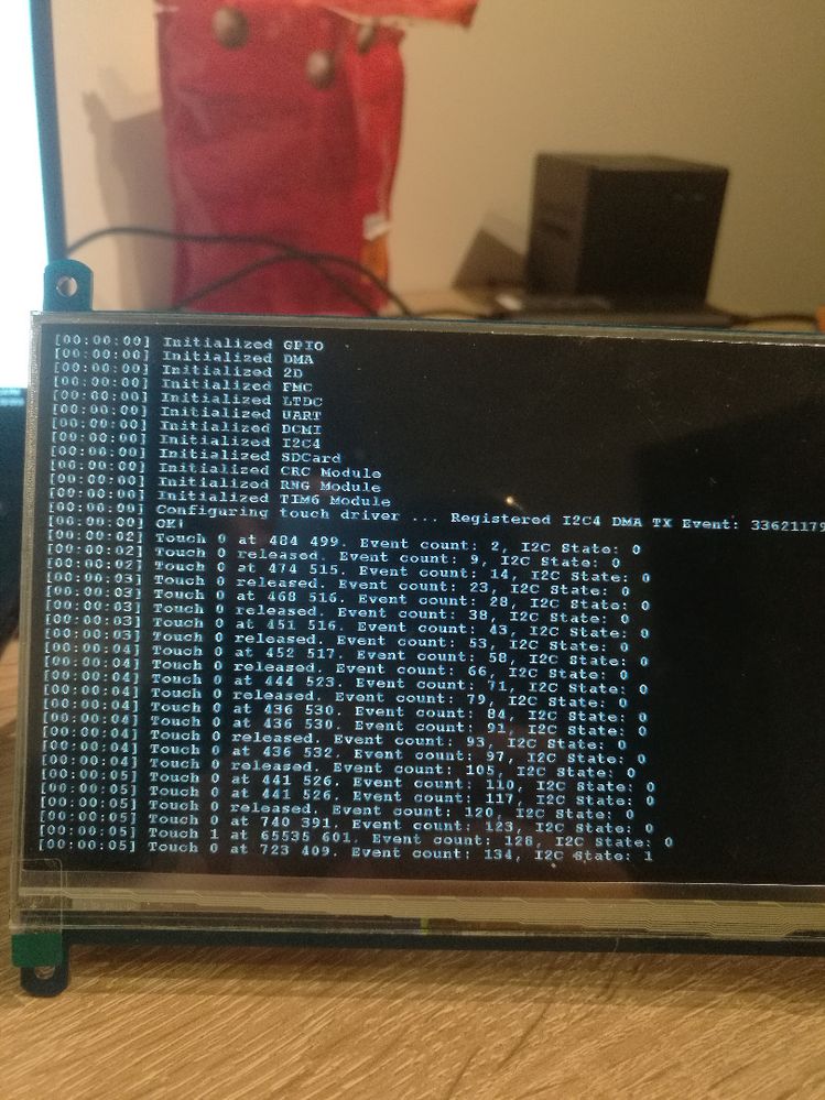

Here is a screenshot of my output:
You can see that the last time shows I2C State :1, followed by no future events.
