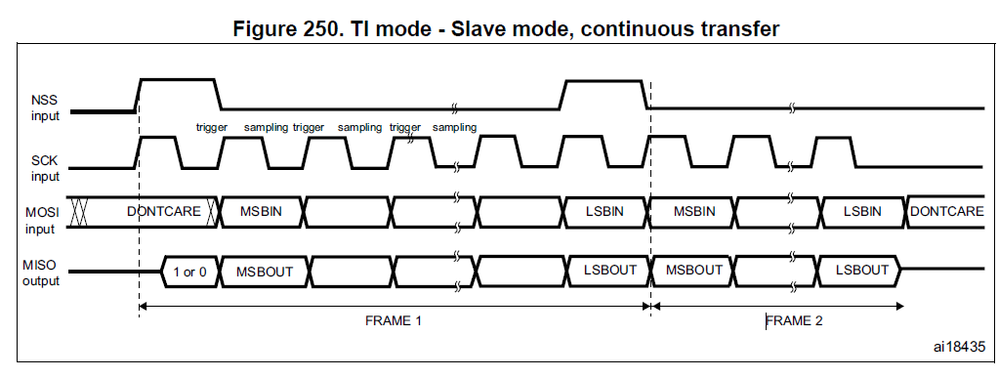

In regular mode, NSS doesn't toggle. In TI mode, a pulse on NSS is output one clock before the MSB. TI mode is not commonly used, but it may work for you here. You would need to increase the frame size by 1 bit and ignore the data coming in when NSS is high. See "TI mode" in the reference manual.

I think NSS signal also toggle with Motorola mode...see Fig.371 of the Reference Manual RM0385.
So, in my opinion, STM32F745 SPI port is fully compatible with AD7274, without major difficulties.
Thanks again for you support.
Hmm. Maybe that’s the “NSS Pulse�? setting or something. Apologies for the misinformation, but glad it’ll work out. I’ll have to check that out again at some point.
