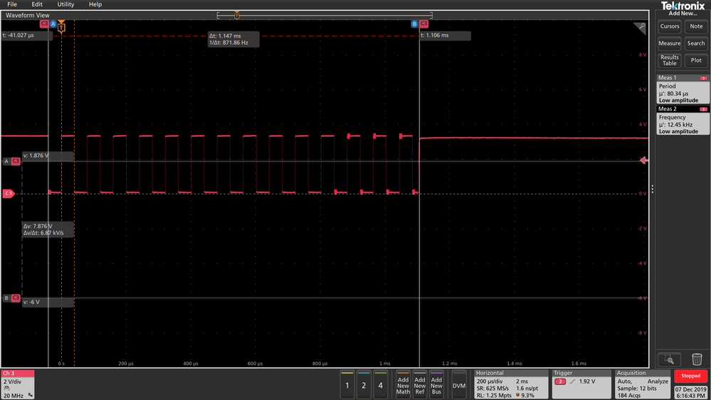

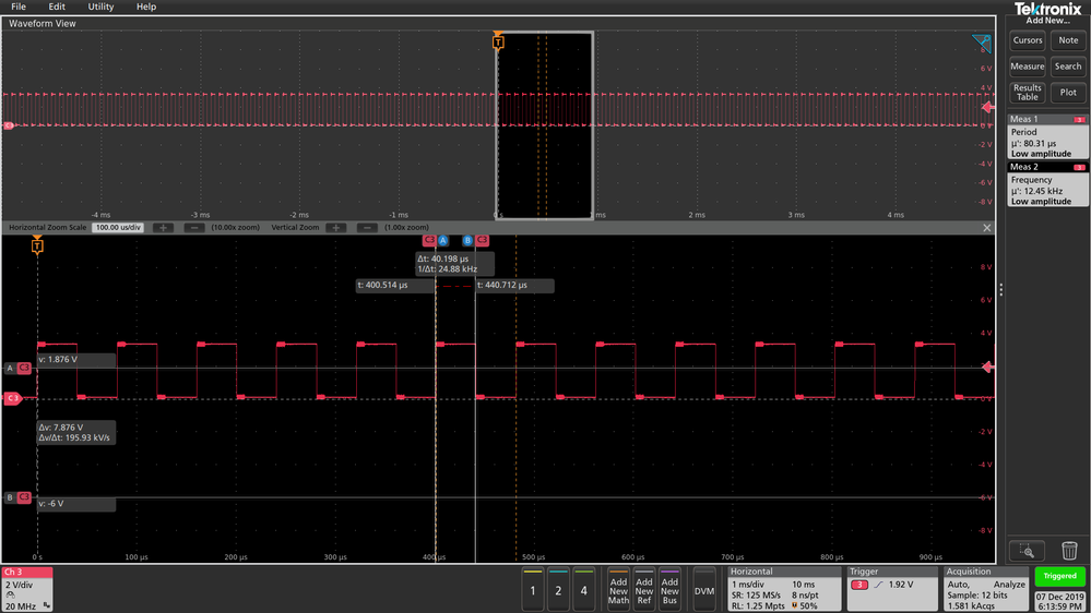

Please find scope screenshots. Figure1 shows Diagnosis output pin, it changes 30 times and after that the microcontroller resets itself where RLR is 3 and IWDG refresh is called every 40us. Figure2 is shows Diagnosis output pin again, where RLR is 4 and IWDG refresh is called every 40us. It is clear to see, if RLR is 4, microcontroller doesn’t reset itself and works as desired.
