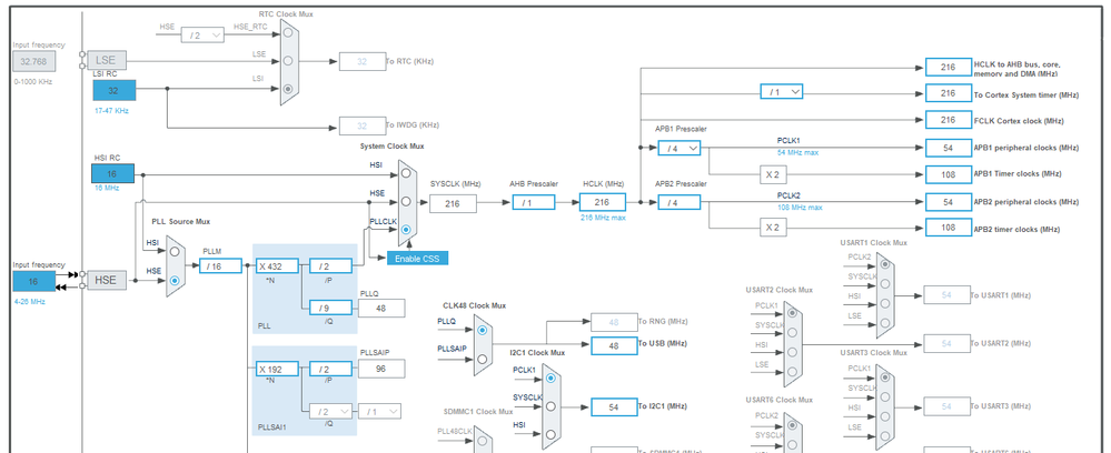

Clock configuration:
Every other Mux not shown in the picture is greyed out

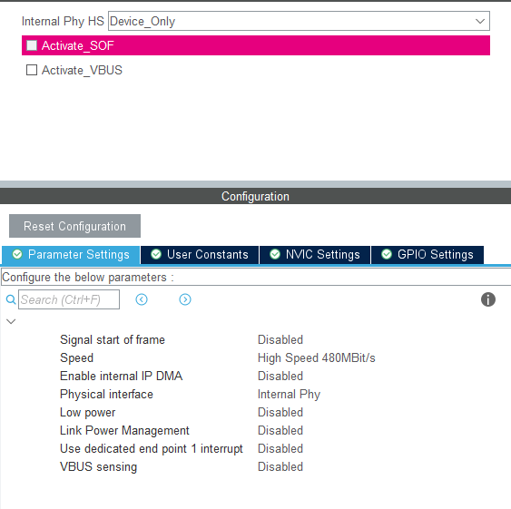

USB_OTG_HS config

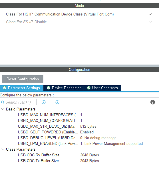

USB_Device Config
