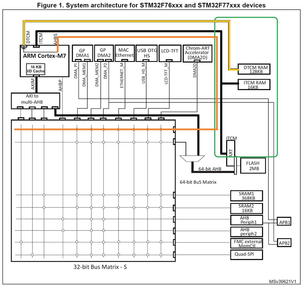

The Reference Manual shows the plumbing, caches and write buffers can cause coherency issues when you're not paying attention. You just have to become more self-aware, and make sure that when the processor-memory-DMA interact. You have to flush (clean) or invalidate the cache side copy.
Green square is tightly coupled memory, it is not cached (see south side of processor) because it is already fast, and you want to apply the cache resources to slower memory. The Dark Orange is the path the DMA data takes to the core, and the Light Orange is the path back to the memory.
You can use the SRAM, you just have to manage it. Review the code here
STM32Cube_FW_F7_V1.12.0\Middlewares\Third_Party\FatFs\src\drivers\sd_diskio_dma_template.c
See ENABLE_SD_DMA_CACHE_MAINTENANCE code sections
The DTCMRAM is a finite resource, I'm suggesting it as a diagnostic test here to see if it addresses your symptoms, as it's simpler to understand compared to the clean/invalidate methods.
