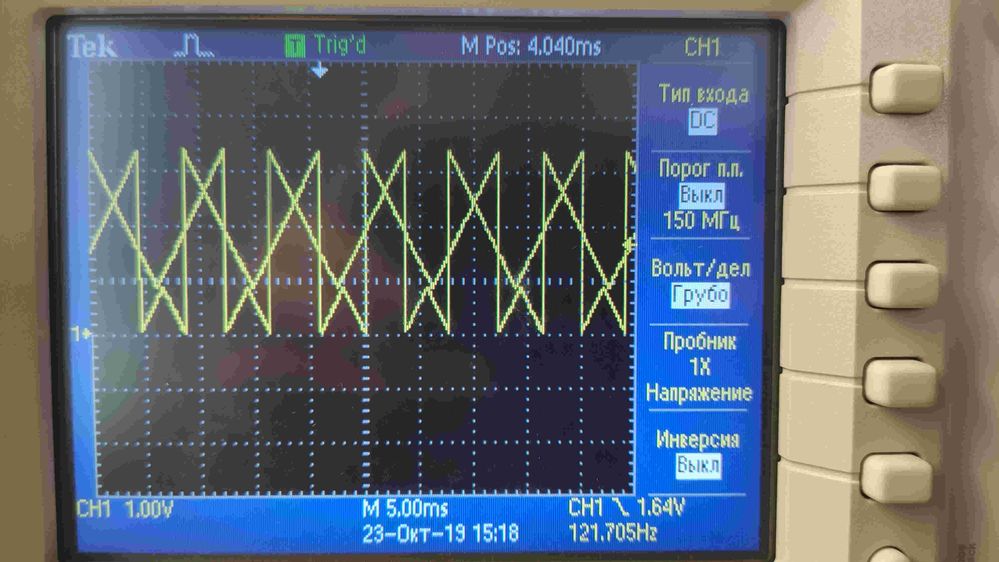

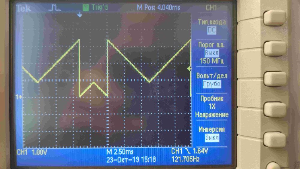

The reference manual says that I can control the amplitude of the signal using the register DAC-> DHRx. Further, to remove the DC, I use a ceramic capacitor, but when I write to register DAC-> DHRx a number any but 0 there, I get some kind of nonsense ...

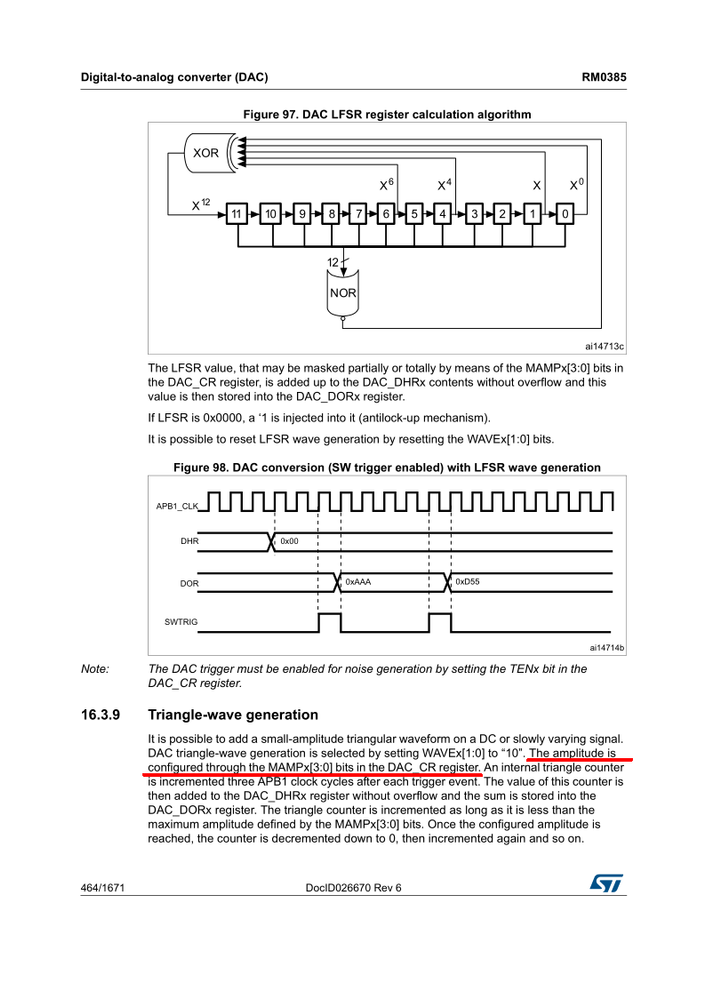

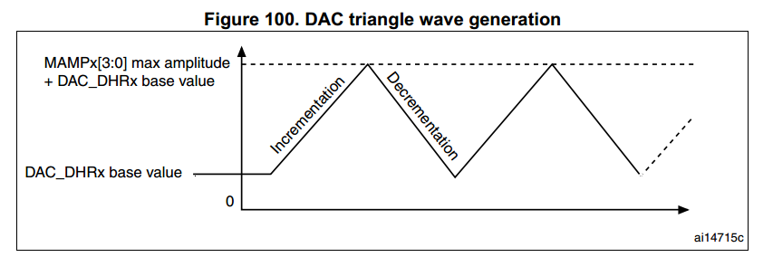

No, it does not.
So, amplitude can be changed changing MAMPx, but apparetly only when you disable DAC, i.e. not on the fly. Due to the simplistic way how the triangle generator works, it will change the frequency, too, so you'll need to compensate by changing the triggering timer's settings.
Read thoroughly the Triangle-wave generation subchapter of the DAC chapter.
