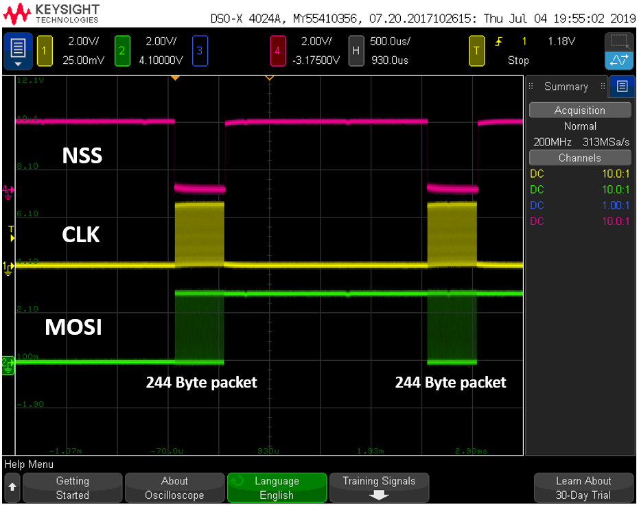

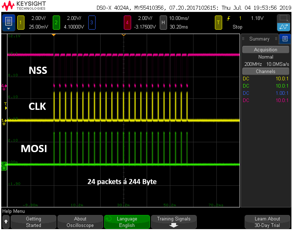

2019-07-04 5:51 AM
Due to the SPI transfer.
Attached are 2 oscilloscope captures of a 5800 byte (netto) (5856 byte brutto to fill up the 24th packet) frame transfer.
So all data will be transfered every time. I checked that several times.

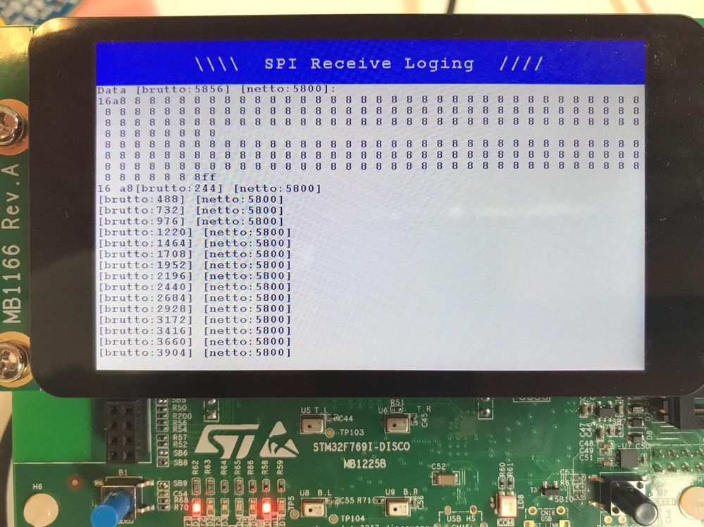

2019-07-04 6:05 AM
These are snippets of my SPI Receive log (print command).
I only print the first and the last 2% of the data, otherwise the printing would take too long.
Here I transfered 5800 byte netto (5856 byte brutto to fill up the 24th acket again).
First the transfer worked fine.
Then the MCU hang up while receiving the next data frame.
A 6 kByte data frame wouldn't even work at the first transaction. It hangs up immediately.
By the way: The dummy data I transfer is just a counter counting up in every byte. Just the first byte is the net amount of data. And the last byte is a 0xFF to indicate the end of the dummy frame.

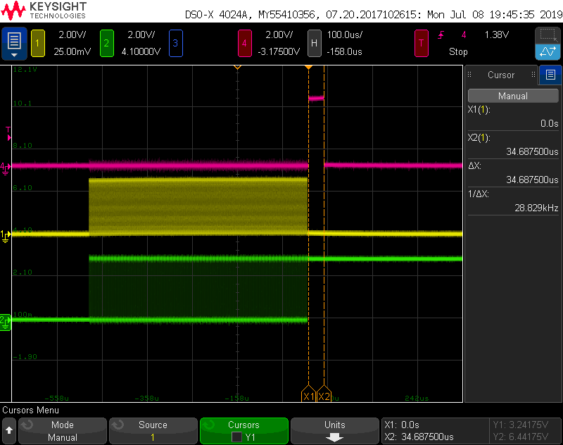

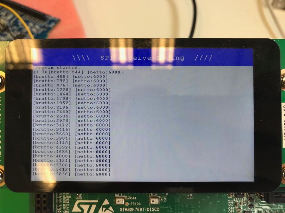

2019-07-08 4:31 AM
Like the Oscilloscope capture shows, the Calback only takes about 35us.
Furthermore, I attached a short video which shows the SPI logging on the receiver board.
At that time, the board hang up after only 2 transmissions. So the last picture you see is a point where the system got stuck. Obviously, the data is mixed up/shifted as well for some reason which I cuoldn't identify yet.
