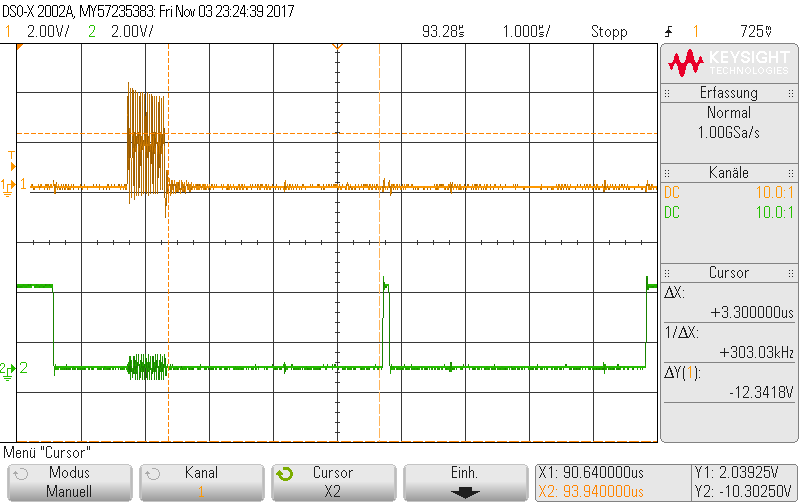

I try to readout a sensor with an external ADC (AD7980). The signal I try to convert runs with 200kHz.
I generate with a timer every 5us an interrupt. With the interrupt I start the ADC and want to read back the values.
But after the end of the SPI transmission, there is a gap of 3.3us. This gap is to long. So I only get every second value.
yellow: SPI_CLOCK
green: GPIO_PIN_7
HAL_SPI_Receive(&hspi3, AD7980_RECEIVED ,2,1);
inter=0;
HAL_GPIO_WritePin(GPIOC, GPIO_PIN_7, GPIO_PIN_SET);HAL_GPIO_WritePin(GPIOC, GPIO_PIN_7, GPIO_PIN_RESET);This is the code behind the scope above.
Is there a way to make this gap smaller?

You looked unsuccessfully, or wrote one and weren't more successful?
Did you try to use the registers and wait on SPI->SR.RXNE ?
Probably don't want to be using blocking code in the interrupt either.

Use SPI 4 wire mode (16 clocks?)
If using a timer to make the conversion pulse at 200kHz, control the duty cycle to be right when the conversion is supposed to be completed. Then make an interrupt on that output compare falling edge event.
In the interrupt, read the SPI DR and back-it up in a buffer, then write on the SPI DR kick 16 bit SCK periods, no need to wait for its completion, the read will be done at next sample kick off.
This is a wild guess to make the interrupt as short as possible considering a pipeline flow of incoming data.
