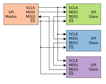

I'm currently working on a device that acts as a slave on a SPI bus, with the intention of being daisy-chained with a number of other devices. The bus master sends out a stream of data with 3 bytes meant for each slave, so the total number of bytes is [3 x Number of Slaves]. See below for a generalized image of the daisy-chain setup.
