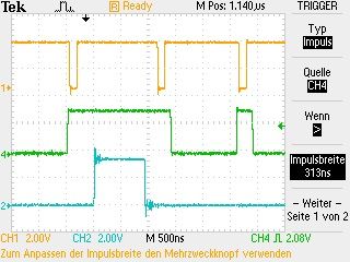

I am working on a custom board with the STM32F746IGT6. in witch is a FTDI Parallel-USB converter is connected to the FMC. My problem is that when I try to read data to ''fast'' from the FMC(after a while, and only sometimes) the FMC reads twice for one cycle. And the read function returns the result from the last transfer. This error is only sometimes and I didn't find any relationship with the content of the data. If I slow the velocity in them I pull data (> 2ms) then I have no more errors. The following image showsthesporadically
two reads at the same call. The yellow line is the read trigger. The blue line is the write trigger. Andthe green lineis an output pin that I trigger with software to recognizewhentheread function is called.

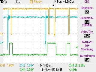

Thank you for your post. It helped me to locate the problem. In fact the problem is an interrupt intermediately or perhaps between the FMC access. It creates a second read from the same address after the interrupt is ended. To test this I used the following code running in the main function:
1.
SETPIN(H, 14); //green signal high
2.
tmp = (*(__IO uint8_t*) (NOR_MEMORY_ADRESS3)); //yellow signal.
3.
RESETPIN(H, 14); //green signal high
Then at the beginning of my interrupts I turned a second signal (Blue) on and at the end off.
I tested this with the USART_IRQ and the Systick_IRQ, with same result.
The following oscilloscope image shows the behavior:
SETPIN(H, 14);

So no indication what could run wrong besides an interrupt handle problem while reading in the FMC.
I suspect that this behavior is the same while writing. But I have not tested it yet.
My solution for now is to turn the interrupts off before the access and to turn them on again after that.
