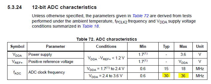

Hi @fbar , according with the STM32F767 datasheet maximum clock frequency of the ADC clock is 36Mhz:
The ADC speed is not directly related with the main core clock, this is the reason because the cubeMX always select to you 36Mhz :grinning_face: .

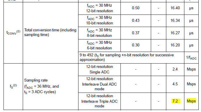

There is a way to speed up the rate of conversion and it's using the interleave mode, according with the datasheet those are the rates that you can reach:

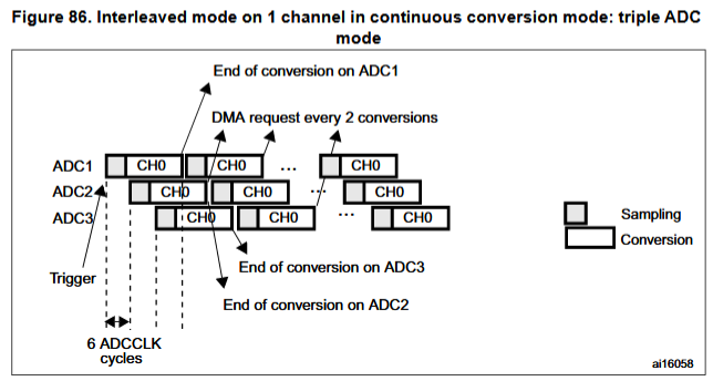

About 7,2Msps, I tested it with the NucleoL476 and it really works (Even with only 2 ADC modules working, not 3). If the resolution its nor critical you could also speed up a quite more decreasing it (8 bits for example. This is the way that works the interleave mode:
Setting it in parallel with the DMA module works fine. There in the CubeMX files you can find a example project to set it.
