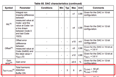

According to the datasheet, there is a tSETTTLING parameter: typical 3us / max 6us with the respect of the load characteritics (Buffer ON) as the following:
So "an ideal square wave" is something not reachable.

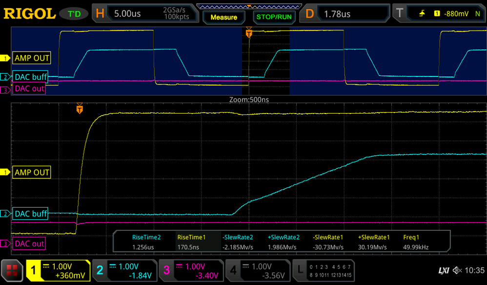

a) DAC with onboard buffer has slew rate about 2V/us (with negligible capacitive load).
b) Clarify how did you made your "scope trace" - it looks distorted
c) Consider using external buffer, then your rising and falling times can be up to ten times shorter (can be seen on following scope trace)
d) If you need realy sharp edges, consider using another method. Like DAC + analog switch etc.
Blue trace - Output directly from DAC (on board buffer)
Yellow trace - output by external buffer (LMH6612 there)
There is also appnote:
