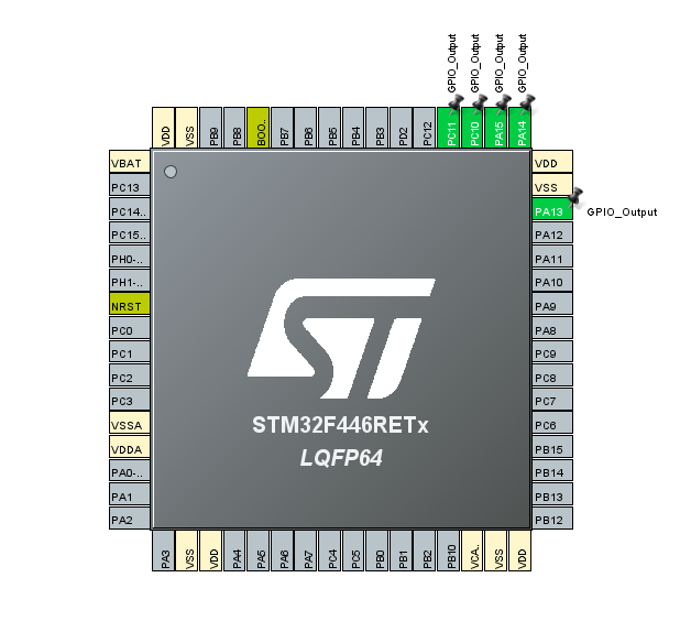

I am working with an STM32F446RE, and oddly, I am able to get one pin to set HIGH using HAL and/or direct register manipulation, but if i try to use two or more pins the debugger console prints out "Device not responding" repeatedly before shutting down. This happens with the BOOT0 pin connected to HIGH, Pulled HIGH, Floating, Pulled LOW, or connected to LOW, as well as any configuration of BOOT1. This error occurs with the HAL library or using register manipulation, and I can not seem to work past this. This occurs on both the STM32 units I am working with, what am I doing wrong?
Just to clarify, this happens with any configuration of pins, but always happens when two or more pins are HIGH at the same time. Furthermore, crashes also result when trying to send serial via the HAL library.

Custom board? can you show the schematic and code you use to drive the pins.
i have project with the same mcu under developement and i cannot reproduce such issue.

/* USER CODE BEGIN Header */
* @file : main.c
* @brief : Main program body
* @attention
* <h2><center>© Copyright (c) 2020 STMicroelectronics.
* All rights reserved.</center></h2>
* This software component is licensed by ST under BSD 3-Clause license,
* the "License"; You may not use this file except in compliance with the
* License. You may obtain a copy of the License at:
* opensource.org/licenses/BSD-3-Clause
/* USER CODE END Header */
#include "main.h"
/* USER CODE END Includes */
/* USER CODE BEGIN PTD */
/* USER CODE END PTD */
/* USER CODE BEGIN PD */
/* USER CODE END PD */
/* USER CODE BEGIN PM */
/* USER CODE END PM */
/* USER CODE BEGIN PV */
/* USER CODE END PV */
/* USER CODE BEGIN PFP */
/* USER CODE END PFP */
/* USER CODE BEGIN 0 */
/* USER CODE END 0 */
* @retval int
int main(void)
/* USER CODE BEGIN 1 */
/* USER CODE END 1 */
HAL_Init();
/* USER CODE BEGIN Init */
/* USER CODE END Init */
SystemClock_Config();
/* USER CODE BEGIN SysInit */
/* USER CODE END SysInit */
MX_GPIO_Init();
/* USER CODE BEGIN 2 */
/* USER CODE END 2 */
/* Infinite loop */
/* USER CODE BEGIN WHILE */
while (1)
/* USER CODE END WHILE */
HAL_GPIO_WritePin(GPIOA, GPIO_PIN_14, GPIO_PIN_SET);
HAL_Delay(100);
HAL_GPIO_WritePin(GPIOA, GPIO_PIN_15, GPIO_PIN_SET);
HAL_Delay(100);
HAL_GPIO_WritePin(GPIOA, GPIO_PIN_15, GPIO_PIN_RESET);
HAL_Delay(100);
HAL_GPIO_WritePin(GPIOA, GPIO_PIN_14, GPIO_PIN_RESET);
HAL_Delay(100);
HAL_GPIO_WritePin(GPIOA, GPIO_PIN_13, GPIO_PIN_SET);
HAL_Delay(100);
HAL_GPIO_WritePin(GPIOA, GPIO_PIN_13, GPIO_PIN_RESET);
HAL_Delay(100);
/* USER CODE BEGIN 3 */
/* USER CODE END 3 */
* @retval None
void SystemClock_Config(void)
__HAL_RCC_PWR_CLK_ENABLE();
__HAL_PWR_VOLTAGESCALING_CONFIG(PWR_REGULATOR_VOLTAGE_SCALE3);
/** Initializes the CPU, AHB and APB busses clocks
RCC_OscInitStruct.OscillatorType = RCC_OSCILLATORTYPE_HSI;
RCC_OscInitStruct.HSIState = RCC_HSI_ON;
RCC_OscInitStruct.PLL.PLLSource = RCC_PLLSOURCE_HSI;
RCC_OscInitStruct.PLL.PLLM = 16;
RCC_OscInitStruct.PLL.PLLN = 336;
RCC_OscInitStruct.PLL.PLLP = RCC_PLLP_DIV4;
RCC_OscInitStruct.PLL.PLLQ = 2;
RCC_OscInitStruct.PLL.PLLR = 2;
Error_Handler();
RCC_ClkInitStruct.APB1CLKDivider = RCC_HCLK_DIV2;
RCC_ClkInitStruct.APB2CLKDivider = RCC_HCLK_DIV1;
if (HAL_RCC_ClockConfig(&RCC_ClkInitStruct, FLASH_LATENCY_2) != HAL_OK)
Error_Handler();
* @param None
* @retval None
/* GPIO Ports Clock Enable */
__HAL_RCC_GPIOA_CLK_ENABLE();
__HAL_RCC_GPIOC_CLK_ENABLE();
/*Configure GPIO pin Output Level */
HAL_GPIO_WritePin(GPIOA, GPIO_PIN_13|GPIO_PIN_14|GPIO_PIN_15, GPIO_PIN_RESET);
HAL_GPIO_WritePin(GPIOC, GPIO_PIN_10|GPIO_PIN_11, GPIO_PIN_RESET);
/*Configure GPIO pins : PA13 PA14 PA15 */
GPIO_InitStruct.Pin = GPIO_PIN_13|GPIO_PIN_14|GPIO_PIN_15;
/*Configure GPIO pins : PC10 PC11 */
GPIO_InitStruct.Pin = GPIO_PIN_10|GPIO_PIN_11;
HAL_GPIO_Init(GPIOC, &GPIO_InitStruct);
/* USER CODE BEGIN 4 */
/* USER CODE END 4 */
* @retval None
void Error_Handler(void)
#ifdef USE_FULL_ASSERT
* @param file: pointer to the source file name
* @param line: assert_param error line source number
* @retval None
/* USER CODE BEGIN 6 */
tex: printf("Wrong parameters value: file %s on line %d\r\n", file, line) */
/* USER CODE END 6 */
#endif /* USE_FULL_ASSERT */
/************************ (C) COPYRIGHT STMicroelectronics *****END OF FILE****/Here is the code in main.c, and here is the board configuration. Thank you again.

>>..but if i try to use two or more pins the debugger console prints out "Device not responding" repeatedly before shutting down.
FFS, PA13 and PA14 are the primary debug interface pins
https://community.st.com/s/question/0D50X0000CBn6FPSQZ/target-is-not-responding-stm32-nucleof446re
2020-03-12 12:30 PM
What I am trying to say is this happens with ANY two pins I configure, I am aware of the debug pins (using micro-usb-b to computer port, via ST_Link), and the issue still occurs.

2020-03-14 8:40 PM
The code you posted is supposed to give the results you’re getting. Because you’re disabling the stlink pins.
