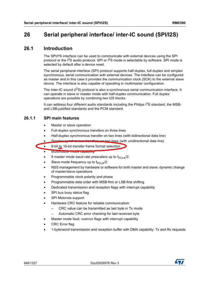

2017-09-12 10:57 AM
IMO, *to* is inappropriate here - as far as I can see, transfer width in 'F446's SPI can be only 8-bit *or* 16-bit.
2017-09-13 8:54 AM
Hi
Waclawek.Jan
Yes, I confirm this typo. It should be '8-bit or 16-bit'
I will report this internally to correct it in the next release of reference manual.
Thanks
Imen
2017-09-13 8:54 AM
Hi
Waclawek.Jan
Thanks
Imen
